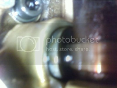

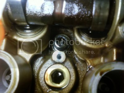

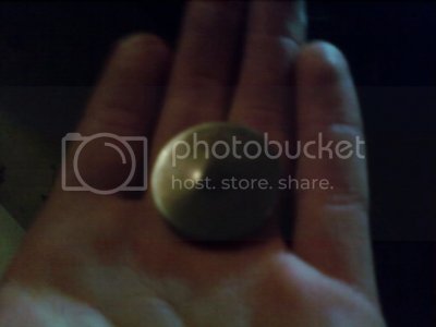

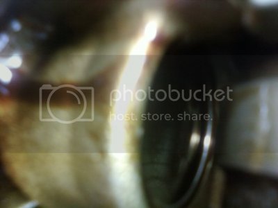

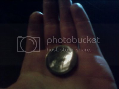

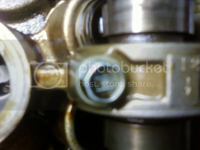

today ive broke down my car and pull vavle covers to find out what the taping was and possible why it was running like crap and what did i find but a thrown shim....(wonderful) and it looks as if the bucket the shim came from is now jamed down what do i do now...? can i just do a vavle lash adjustment or is it really to late for that the cam looks find no scuff that not on any other one and what do i so with a stuck bucket.....??? do i need a new head and cams or is she just in for the top 60K. i have pics ill have sholover719 put on when he see gets back

pics of thrown shim

Definitely need a valve adjustment. I would inspect the bucket and see if it needs to be replaced. Chances are it needs it. Also make sure the cam is in good condition.

Well your going to have to pull the cam out, check the cam real good.. also once you get the bucket out it might have messed up the head. You might even want to pull the valve spring to check all the way down for your clearance. last one that I seen do this messed up the head.

This Is the exact same thing that happened to my v8 I threw a shim and really screwed up the bucket. I had to remove the cams to get the bucket out, and after getting the bucket out I noticed that it had made the valve hole bigger and all scrapped to crap. Save yourself alot of time and fustration, take the head off have it checked for a bent valve and also incase any dibriss fell into the valve. I did not do this and I had a bad valve and anouther had a broken chunk of the bucket jammed in it. I ended up getting a used head and having it compession checked and made sure it was not warped. Plus I had to have the cam polished back because of a nick in it. I have finally got the car put back together and driving it. Just trying to save you some time and alot of bad words.

I have the same problem with my 93 3.0. It's now a parts car.
The problem is that the valve will not return to the fully closed position.
The only real fix for this is a head swap.

It does not always do that much damage. My 89 displaced 3 shims and damaged 2 cams about 7 years ago. I replaced all 4 cams + seals with a nice matched set as well as the buckets and completed a fresh valve adjustment. That car has less than 4 psi difference on compression between all cylinders and it still runs great.
Don't make any assumptions before a careful disassembly to verify where your at. If it looks like you came out lucky then replace whats necessary and run a leak down test afterwords to test for any unnoticed damage.

Holy crap , these shims are super strong - its the first time I see ones that much *****'ed , looks like the 50 cent they shot on mythbusters with a black powder rifle.
