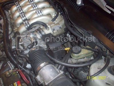

I run air through mine that feeds the PCV system and the brake booster/EVAP manifold on the firewall.........:naughty:
I like this idea a lot, it takes the TB coolant delete one step further by keeping a little air moving through the TB to add whatever additional cooling it can.:thumb:

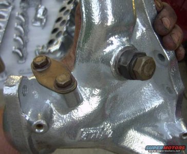

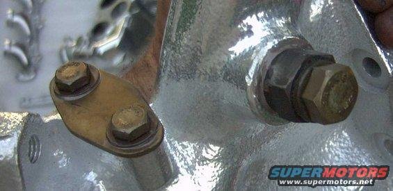

This is what I did to remove the EGR (and SAI) system. The Gen 1 SLO Vulcans didn't have an EGR system, but the UIM was cast to accept one in the future. They made an aluminum block plate for the EGR that fits perfectly on out UIM, and with a little hogging of the holes it also fits the plate on the exhaust manifold. Cost me $5 for two plates from the local junkyard.
For the SAI system I took the OE flared to MIP adapters on the manifolds and cut the flared end off and tapped it to accept 1/4" galvanized plugs.

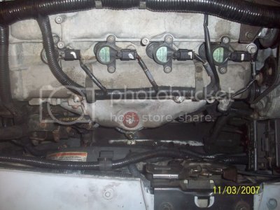

I should add that I now do not draw the PCV makeup air through the TB but just what ever is used by the manifold on the firewall. I run a sealed crankcase on the intake side. Run the exhaust line from the oil separator through a condensation can, then to the PCV valve into the intake. Reduces the nasty sludge down to about 0.

I cut the SAI fitting flare off then tapped and used a 1/2" bolt to plug the hole. Here is a picture and it also shows the EGR block off plate on the exhaust manifold.
R manifold with sai plug and egr block off plate 2
R manifold with sai plug and egr block off plate 3
