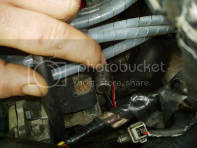

did you hook that lil resistor looking thing up to the Coil pack when you bolted it back down?
50620049
that thingy that I'm half assed pointing at.
Also, are the bolts for the crossover tube good and tight? Them are the grounds for the DIS...

That's a good question. Even though I'm at work, I'm on my lunch break. Let me go check that.

Yes, it's plugged in. Everything else seems ok. Previous to this, I was having an issue with cylinder 3 only. I wonder if this CP/DIS is failing.

Start tracing wires to and from the coil pack and the DIS. Take a close look at the wires near the ground strap on the back of the intake manifold.

The rear grounding nut decided to commit suicide. Either that, or I didn't tighten down enough. I take blame for nothing! Went to AZ, got a new nut, hooked up the ground...bam...no more misfire. Once again, thanks guys!
