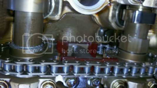

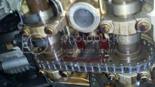

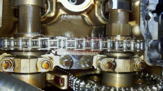

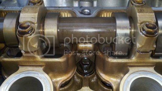

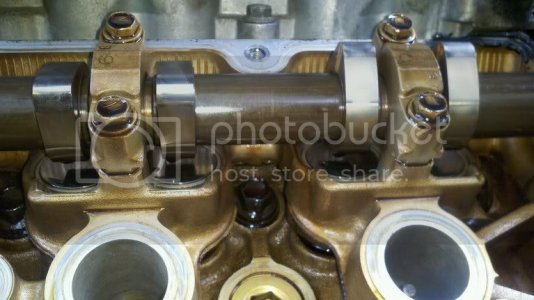

Well the car has been down a week now and this mecrury cougar I'm driving I hate. So I took the valve covers off this morning to find that the intake cam has sliped and has bent atleast six of the valves. There's about a 1/4 inch of clearance. The other cams look like they were about to slip as well.
So now I'm stuck with no Sho. And I'm wondering what to do next. I have no money. Only this 93 couger I plan on selling or trading.....I will post pics in a bit.

I just remembered I never posted pics sorry for the delay. Been in rough spot here at home.
Photobucket 2573 1316707291058
Photobucket 2472 1316707288739
Photobucket 3071 1316706752470
Photobucket 3279 1316706750119

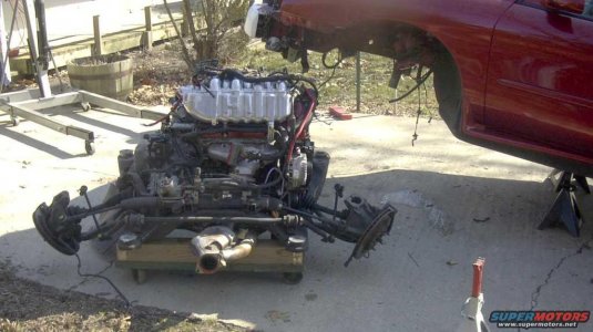

The back side.
Photobucket 2801 1316707293035

Thanks....so just curious. Once I pull the engine from the car how hard is it to pull the head off? Or would someone purchase a broken v8.
SHOZ123
Dec 2, 2000
12,152
673
Illinois
Removing the head is pretty easy. It's a lot easier to retime it too when it is out of the car. Just be sure to have a factory manual to go by for procedure and torque specs.
