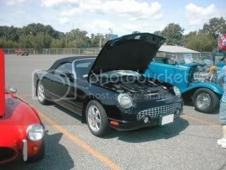

cuz those rims are sick lol the stock rims are ugly on the 02 models
