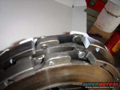

I know that the Clutch Masters Stage 1 clutch that I have the new pressure plate is rebuilt with thicker straps and larger rivets. Clutch Masters in the rear stock in the front on the attached pic below:

the stage 3 had aolt of miles on it, alot of really hard miles on it i actually did the same thing, missed second gear and jammed it back in just like before about a week ago and the stage three plus didnt miss a beat! and i still havnt even had that clutch slip at all, even after a sat. night of drag racing and driving really hard. i think youll be fine with the stage three. it chatters too much cause its a puck style but if your not a wuss youll be fine with it i was fine with it. the above pic is about what the spec pressure plate looks like too.
