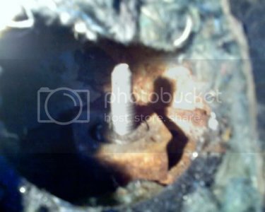

ok guys, attached below is a picture of what the shop found when they cut a hole on the drivers side of my car. they were stumped as well as I. is this what its supposed to look like? if so, how do we get the old nut out as it looks like one huge plate welded to the floor and is much too big to take out of the newly drilled hole. there was no hole in the floor before i took it to the shop, so it could not have had the recall performed. is there any other way to access those nuts besides cutting a floor. im thinking the past owner might have had something done. thanks in advance.

That's not a factory subframe kit repair, that's for sure. Two possibilities.
First, someone had this done by a non-Ford service shop (ie. someone unaware of the recall had the subframe drop and took it to be repaired).
Second, this was one of the "early" subframe failures, before the problem had been "acknowledged" and the Ford recall was announced (and recall kits were made available).
Was there any evidence from below, that the replacement "nut" had been welded in? Was it this way on both sides?
Also, by the look of the image, I would pull the carpet back further and make sure the access hole/plug wasn't place higher/lower on the floorboard pan.

i have not seem the underside of the chassis where the nut would be, since the subframe blocks it. i have not seen the other side since the shop didn't cut the other side out. when they saw this, they were shocked and stopped. i will look to see if there is another hole, but i didnt see anything when i pulled the carpet up. this really has me stumped. i contacted the previous, who used to be a member here, but he has not answered yet.
Edit: i meant to include that i told the shop to go ahead and cut a hole on the passenger side as thats the affected side(it dropped). i guess if the other side is normal, ill let the drivers side be, and it will just be a mystery.

no. that picture is of the drivers side. the passenger side is the side that failed. i dropped the subframe during the engine swap and that bolt wouldn't tighten up. the nut is spinning, but i haven't seen it yet.(the shop hasn't called me yet):madflame:

still rather trust an independent shop to do the work. they cut the hole and the passenger side is normal. but it had the updated nut. i pulled the carpet and insulation way back and they were no other holes. how did the previous owner get this thing in there?

I think my car had something like that happen. When I went to the ford dealership, they said someone had welded something. I never made it to the dealership to look at it, but they had to send the car to a frame shop where the part that was directly under the nutplate was cut and bent back or removed to gain access to the welded nut plate. After they did that they welded it all back up and continued with the recall as normal. A free recall ended up costing me $200.

alright guys,well i got my car back from the shop. all buttoned up and riding great(handling wise). i would still like to know what happened to the drivers side but i guess it will just remain a mystery.
