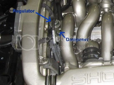

It's on the fuel rails...on top of the intake. The one in line with the fuel line is the regulator and the other one is the pulse damper...or it's the other way around...I can't recall.

Here it is, but X2 check out that MAF first, and also do the gas cap test.
FuelPressureRegulator
