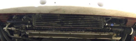

i just picked up my first gen III last week and i was poking around a few things and i noticed what appears to be a fairly sizable cooler unit in the front bumper. i know the stock coolers have been described to me as just a simple tube, what i have is a rather large finned unit that runs along the length of the bumper cover in front of the a/c condenser with 2 1"(aprox) hoses going in one side and 2 1" (aprox) hoses going out the other side. I'll see if i can snap a photo when its daytime. the car needs a trans anyway but i just thought id ask.

Snap a pic. I forget what the GenII SHO trans cooler looks like but it might be that.

A lot of people like to use the Gen2 coolers; apparently they're better. I wish I had known this 4 years ago when I threw out my cooler for, basically, a second (tranny) radiator.

With the G2 cooler, radiator cooler bypassed and the steel OEM lines in the garbage the only problem may be over cooling in the winter. But then again this is only a problem when the temp gets below 10F and you don't do any stop and go driving.
