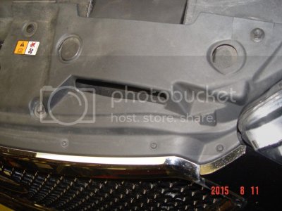

Just the slot that lets air into the air box...I removed about 1/2 inch from the bottom of the slot....Hard to say if it does anything, but it should allow more air into the air box.. I forgot to mention I'm using the Windstorm CAI .....Rich

I'm also using the Windstorm. I still wonder about the purpose of the slot in this pic.

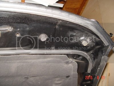

My car has a seal at the hood edge along with a seal further back as shown below which totally isolates this slot opening. Did all years sho's have the forward seal at the hood edge? Has anyone cut this for airflow to the slot?

I noticed that on my 15 as well. I considered cutting, but it make me nervous to make irreversible changes. I think I'm going with the fender tube out of the factory airbox myself. I can plug the hole if the need arises with a hole plug.
9,045
4,390
I believe that is the factory inlet for the Flex, but not used on the SHO. MDesigns' product does use this inlet, and the newer Fusions/MKZs also have an inlet in that location. So the factory is plenty confident it can be used without risk.
