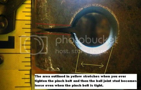

Here's a pic of the underside of the ball joint stud hole in the knuckle. It looks to have a nice consistent taper. There's not much of a gap to start with between the ears in it's relaxed state. I'm thinking I can get away with shaving a little material from each side to obtain a tight pinch. What do you guys think?
93rev2sev
Nov 1, 2004
6,461
1,825
Hockeytown
Knuckle
Th knuckle is already compromised since it's already stretched, so grinding a bit of clearance should be fine as a TEMP FIX. You really need another knuckle and you do NOT want a failure at speed.

The LCA's are definitely the correct ones. (non-SLO)
The OEM hole has no taper, if yours has a taper, the knuckle is done, you should replace it for your own safety.
The only Ford OEM difference between the SHO and SLO LCA was rubber bushing durometer: The SHO bushings were stiffer to control toe changes and lessen the effects of torque steer. Any changes in the appearance or cross-section of the forging was probably due to different part vendors or running design changes/cost thrifting.
Don't overtighten it...I think it only calls for about 45 lbs.

Thanks everyone. I opened the gap to 1/8" and was able to tighten the stud with about 60 ft-lbs on the nut.
I will look for a new knuckle asap.
