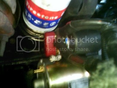

Seems I am crazy, I must just never notice it while under the car :bonk: Looked up some old pictures I took when an old starter was going haywire and there it is, goes to show how much I pay attention while I'm down there.
Starter 2
I felt like I was losing my mind, now I gotta try and think of just who else I've changed oil for that didn't have a cooler, I haven't touched any other car but my own in a year or two :nuts:
