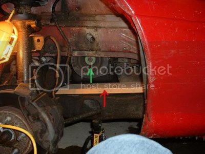

Step3b
Follow the green arrow, the ****** has the green dots on it. You can use a hole saw that will clear the head of the bolt to cut it.
Ignore the red arrow it was on the picture when I stole it to point out the ******.
You can take a look at this thread too for reference, there are even videos at the end lol.
http://www.shoforum.com/showthread.php?t=102534
Make sure to track down a new crank bolt to buy if you have to cut the ****** because you cant get new ones IIRC.

so if i cut that ****** then i try to remove the bolt as normal? am i trying to cut out the entire green dotted piece or just the space behind it so i can loosen the bolt?

The ****** is what is providing all the claming forces...When I cut the ****** off of the bolt that withstood 300 foot pounds, I was able to spin the rest of the bolt out with my fingers. No guarantees, but I'd bet you will be able to get the bolt out once the ****** is cut off.
Take a look at the three videos on page 4 of the link in my other post, you can what they cut off. Again, make sure you have a replacement crank bolt lined up before cutting.
