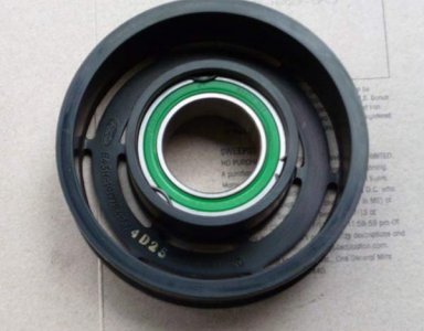

You look so nice when you are new...
BgamrJI

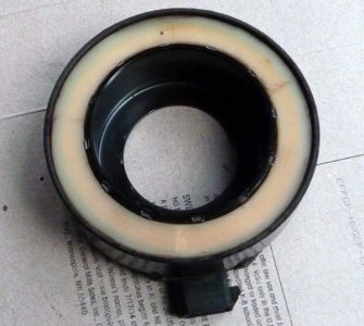

Even your coil is pretty:
DOwo2c5
But then you go and do this:
RCjAdPF
7ec
And before you break the serpentine belt, you chew away on the coil and turn it into melted char.

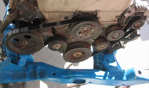

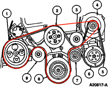

OK, pulley, I'm stuck far from home, but we can bypass you with a 70.25" belt says some painful forum cel phone browsing. Here's my illustration of other's words:
6gkBDC3

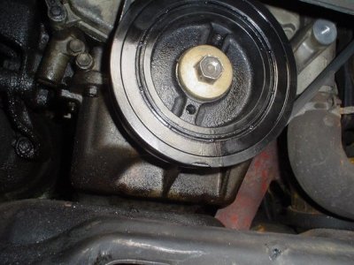

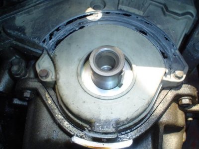

But you're not done yet, AC pulley, because that $34 belt is destroyed soon after when it rips into engine block metal, because you did this to the harmonic balancer:
H1EKQlz
And that crank pulley eats into the timing cover before it starts squealing into the metal lip on the bottom of the engine. And I'm only mildly far from home.
Get another short belt since the last one was shredded. Discover that it didn't just die prematurely from the weird bypass; it was from aforementioned pulley. Luckily this was discovered by double-checking the belt, it was being thrown out of the grooves and rubbing, something wrong here. Discover that the ATX harmonic balancer separating is not rare.

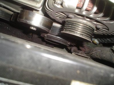

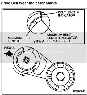

Well here's the trick, I guess. I gift the forum this rarely seen ATX tensioner guide with impossible to notice marks indicated:
Tensionerarrow zps1e5b4eb8
At some point I must have thought that weird idler pulley wrap for bypass was redundant, so I removed the top pulley. This shortened the belt path and made too-little tension, creating a noise like metal-on-metal like something was going to fall of the car; nothing at all like a belt slipping noise. I finally was spraying each idler pulley bearing with WD40 through a long tube while the engine was running, and the noise stopped for a bit. Spray more, maybe it quiets down...Hrm. Douse the belt in belt conditioner spray, it's quiet - until the stuff dries. Aha, belt. Why? OK, I put the other pulley back in and wrap the belt the original way, and it's friggin quiet again! About a dozen battery-pulls later...
Well, now it's time to try to get off the AC clutch snap ring while the AC compressor is still in the car (I can spin the shaft with my fingertips so the compressor is fine), put on my new AC pulley (the old bearing still spins but feels gummy), buy another belt, and it better be done.

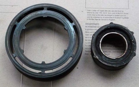

I thought a tire had exploded with all the noise it was making when the belt snapped, I ended up with just shredded bits of belt and this when I opened the hood.
Dsc02271small

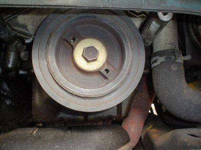

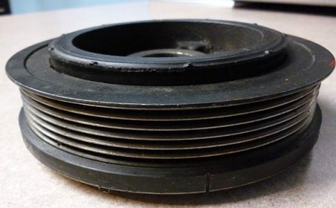

I ended up bypassing #7 idler after gutting the ac clutch. It also killed the new belt I put on because I didn't even see it had killed the harmonic balancer.
Dsc02564small
Dsc02567small
Dsc02568small
Fun times.. :biggrin: Sold that car, on my MTX I just run the solid shosource UDP and don't have to worry about it.
7,521
It is possible that the crank pulley/dampener moved first, and the resulting angled load was was killed the a/c pulley.

I was looking at your bypass routing and I don't think you will get enough bite on your water pump. Try routing from crank to other side of pulley 7 then to alternator. Then route as normal still using pulley 3. Use belt part number 6PK1890, its a 74.4 inch belt search for it on Amazon. I found a picture and will try to post it.
NoSlo
SHO Owner
Aug 21, 2003
908
655
Portland, OR
The picture I am referring to is in this post, its an older post but it might help with your routing.
http://www.shoforum.com/showthread.php?p=762436
Hope this helps
I think you mean this:
Paccbelt
That won't work unless you remove the AC and make a replacement alternator mount, or at least remove the pulley and clutch from the AC compressor (which takes tedious work with a ring-spreader tool) - in the first-post belt diagram, you can see that it would hit the AC compressor.
