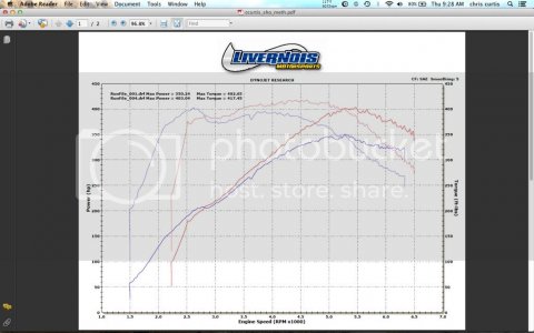

The factory convert already stalls 2500rpm which well into peak torque with LMS tunes. And traction at the track is already a problem at the track, I see no benefit at this time.
File 1
