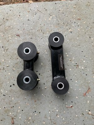

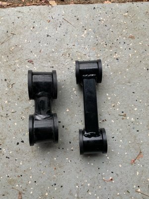

Your guys product is amazing! Look at those welds. Did you set up the long mount with that bend and twist for a reason in particular?
20190919 143010
On the short mount.....is it not straight for a reason also? Those off center welds are impeccable. You guys really out did yourselves. The powdercoat looks A+ quality as well.
20190919 143029
Weird, I haven't heard a peep about quality ect from other owners about "the third party"........

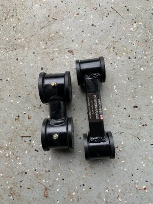

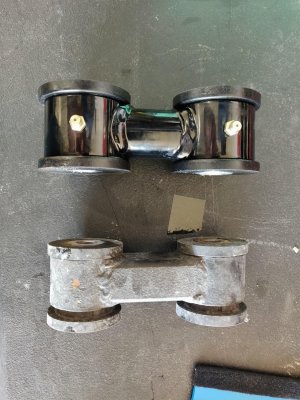

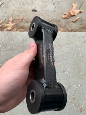

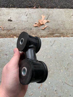

Just providing my experience...
See the attached pictures of the mounts to make up your own mind...
The AD mounts were $225, came with grease fittings, and only 1 style of bushing on his Gen 2. Absolutely nothing wrong with quality, bolted right up, did it’s job.
The SSM mounts were $180 but came without grease fittings although they could be added, and multiple choices of bushing stiffness. They bolted right up and did the job. Ran an 11.9 full weight with no wheel hop. Nothing wrong with the quality I received.
I choose to try a different bushing setup because after 5K miles and lots of track time the AD setup still produced more NVH than I wanted. The SSM options included a “Hybrid” setup that they said had factory levels of NVH while eliminating the wheel hop issues of the stock mounts. Thus far I can conclude they are correct.
There is nothing wrong with either setup, it’s all in what you want. I have built my SHO to maintain as much of the comfort and “feel” like it rolled off the show room floor but with the performance it should have had. The SSM Hybrid setup fits my goals more closely than the AD setup.
