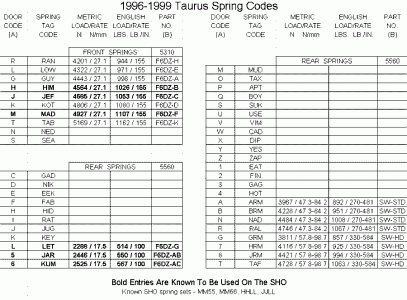

Further investigation has been helpful - My door code is MM55, which leads me to the part numbers
Front - MAD
Rear - JAR
It appears that the list prices on the Ford springs aren't terrible compared to aftermarket, unless they have gone up without warning. Sometimes the online catalogs are misleading as to current price.

Well, I was able to find a pair of the front springs (code MAD). It looks like the two rears that are normally paired with them (JAR and ***) are both unavailable. Has anyone ever mixed and matched on a set before? I know the later cars that still had SARC (98) used LET on the rear, though paired with HIM (which both have a lower load/rate).

All the Ford Taurus springs for the Gen 3 have the same amount of coils and the spring rate is the same. What is different is the length. The longer the spring the higher capacity.
