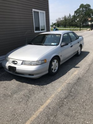

Hey guys,
So I just bought a 92 MTX and it drives but has power steering spraying onto the exhaust, kinda a fire hazard for driving home 8+ hours. I’ve got a spot to work on it, any suggestions on the problem/what I need to get to fix the leak?
