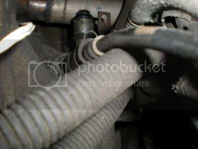

I am having a hard time locating the assembly. Can anyone explain or post a diagram/picture of the location? Thanks
7,521
follow the speedometer cable down to where it attaches to the trans.
a pic is difficult because its hidden under a couple bundles of wiring, a few coolant hoses and assorted other stuff. its hard to find for the same reasons.
