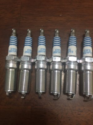

Just got this s/p NGK - LTR6BHX #90495 from Ford Racing, THEY DON'T LOOK LIKE THE NGK RUTHENIUM !!!! And if this's the right ones what's the gap ? Thanks

Those are the M-12405-35T, the factory Ford GT plugs that most tuners specify for the Ecooboost. They are great plugs, did you buy them advertised as Ruthenium plugs? These are $35 for a set of 6 plugs where the Rutheniums are $45 for a set of 4.
They are great plugs for the Ecoboost, but if you bought them under the guise of a Ruthenium plug I'd definitely contact the vendor you bought them from and ask for a price adjustment.
Gap will depend on your tuner, as each specifies something a little different but in most cases 0.026-0.028" will work great for you.
