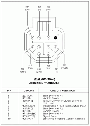

Check the resistance of the solenoid. Should be 0.98-1.6 ohms.
With an ohm meter check between pin three and the transmission body. This connector is under the intake hose pointing up.
C168 transaxle
C168 transaxle

Well can't say for sure. The .80 ohms you read is below spec. I would assume that that is what needs changed. Even if it isn't the TCC solenoid that is the source of the problem and the problem is the actual TC, the solenoid is bad.
