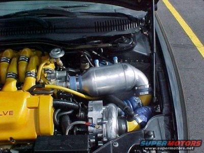

I used a PWR unit. Here is a pic before all the liquid lines were connected.
MVC 301F
The lines run under the car to the reservior and pump in the trunk. The other side of the pump runs to a Power Strokes Transmission cooler that I scavenged as the liquids radiator which is mounted in the lower portion of the grill. Barely fits but it looks like it belongs.
