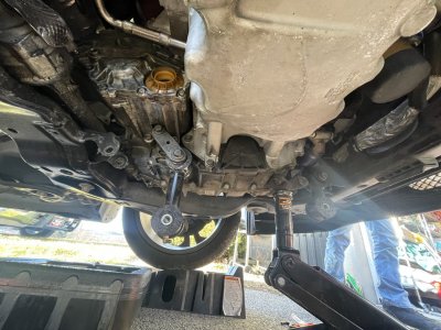

Just got my AD Transmission Mounts and haven't looked to hard, but didn't really see the front mount! Is it under the battery? Any suggestions would be helpful. Saw the video but I think that was an Explorer. Thanks!

Theres both of them, left of the jack and right of the jack
Oh thats how you cheat when doing ptu. Disconnect the front mount and push up on that point to swivel the engine forward and the ptu will just fall out if its unbolted

Depends on the year, my '18 didn't have a front, so if you can't find it... that's why.

It probably is one that doesn't have a front mount. Do some searching on here I know someone posted all the Ford part numbers to add one. You definitely should if you're going for performance. EcoBoost Xsport might have been the one that did the write up
