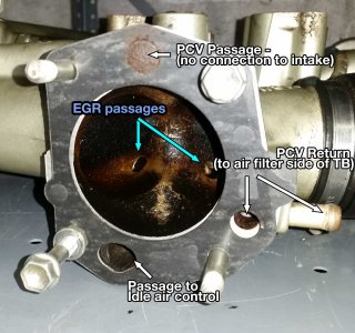

Since I happen to have a throttle body sitting around:
Pcv tb1
The large PCV tube and central PCV chamber can be cleared out starting with large drill bits (by hand) if there is corrosion or hard carbon deposits. Then it will take some poking with wires around the blind corner in the inlet and some hot water, carb cleaner, etc.
The two small PCV holes inside the throttle body are where engine vacuum normally pulls gasses through the PCV chamber. They are more easily clogged. Stiff bent wire or a broken-off drill bit pushed through them with needle-nose pliers can be used to clear them. One might even enlarge the first small hole a bit.
The larger air passage in the throttle body, on the other side of the throttle plate, is open to the air filter and normal air pressure, and puts any excess PCV blowby into the airbox before the throttle plate. Because this flows rather freely, this prevents the little PCV holes from applying any significant vacuum to the crankcase.
Pcv tb2
The PCV "return" here is where fresh filtered air comes from the airbox, and via a hose, enters the valve cover to replace any gasses sucked out by the PCV system.
If there is too much engine ring blowby combined with plugged ports in the PCV system, then the flow of the valve cover hose can reverse. If it does, oil is easily picked up by the port on the valve cover and enters the intake.
Again, see this post for diagrams of how PCV gasses flow.
