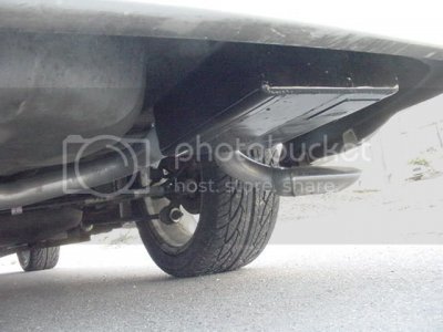

Side exhaust has been done with the stock tank in place before the rear wheels... are you doing a dump after the rear wheels that would kind of be in the way of the tank?

What I am trying to do is have the same exhaust pathway on the passenger side in front of the tank, like the driver side is on a stock SHO. In which case I will most likely have the tank modified. The exhaust will dump in front of the rear tire. There will be a series of round body mufflers in the center section of the car. Exhaust diameter will be true dual 2.25 from the stock manifold back.
My idea is to have a good sound and fairly high restriction in the back section. Primary ports in the stock manifold is 1.5. Research claims main pipe should be 50% larger than the primary port area. 1.5 -1.6 L four cylinder engines have as large as 2.5 inch exhaust with no low end loss on dyno.
The kicker is a dump 2 - 3 feet from the manifold activated by the secondary system. This bypasses the series of mufflers and allows straight pipe exhaust in the 4,200 rpm on up.
So, the car could have a good tuned bottom end and a tuned top end.
