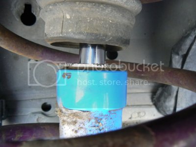

Well.. I noticed when looking at my suspension today that the "nut" which is the top of my strut, I'm guessing from a rebuild kit... kind of like a Koni install... but its a Tokiko.. anyway... the thing is backing out... its almost flush on the other side of the car, and this side is a good 1/2" sticking out.. 5 or 6 threads worth..
Should or could I turn this in with the car hanging? Or should I put weight on it... or ???? How many threads are there on those? HOw far do those screw down into the body there?
Pics coming..
Eric VerValin
PiMPSKiLLET
Mar 28, 2005
3,187
649
Fort Wayne, Indiana
Negative, holds the "goodies" inside the strut tube itself. Like if you cut a monroe and use an insert... these threads..
One side...
P1080647

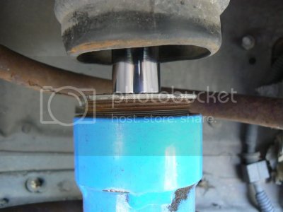

The other... showing a lot more threads.. half of these are shiny..
P1080648

Oh snap. I wonder if it's still charged with nitrogen, or if it bled out by now... That's scary lookin.
kevinspann
Don't take my advice.
Sep 30, 2007
3,166
1,884
Richmond VA
That should be what holds the Tokico cartridge in the housing, so he is all good as far as still having a gas charge.
