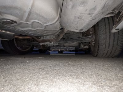

I have the original Borla full catback (pic). It's got a really nice sound, not loud like Flowmasters, and the sort of ripping cloth sound. At least one local club member said he was going out to buy one after he heard mine. So having a resonator (I lightened it in the picture for visibility) can make the mufflers sound nice. It is joined at the resonator like the OEM was, it might be interesting to hear the system as true duals but it would be tough to find room for a second resonator.
