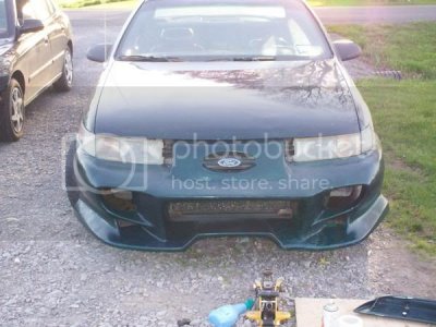

Isn't that how it always is your in a good mood good day then bam. Same situation, my daughter was just born in the hospital and the ex girl was allowed to eat what ever she wanted so off i went to get her taco bell when bam i rear ended someone. Turned a awesome day into a frustrating day... Worst of all i had made a body kit for the car that weekend.... All i had to do was wet sand it and paint it again! :(
