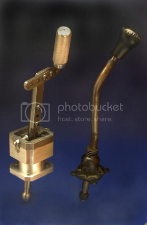

Does anyone or any place make a short throw shifter for a 1995 SHO MTX, Or something similar that works? (Generic) I race mine dirt track racing and looking to be able to shift faster from 1st to 2nd. Thanks

There isn't any place to buy a short shifter new. There was a guy named Jose that offered two options for short shifter but he hasn't been active in years. One option was a completely fabricated(SHOrt) shifter that he designed and built. The other was a way to modify the factory shifter(SHOrty) . Search "Jose SHOrt shifter" to see his old thread. I have used both and prefer the second option and currently have one in each of my 2 modified SHOs. You might be able to find one if you post a WTB in the classified section. You might also join the SHO Marketplace on Facebook if you haven't already.

2nd option meaning the short or shorty? Thanks

The one that I prefer is the SHOrty. It's a modified stock shifter. Very smooth movement with a much shorter throw.

Alternatively, you can also get away with cutting about 1" off the stock shifter rod and not change the geometry of the feel or your shift changes.
Once you have it cut down, you can go ahead and thread the rod so the **** goes back on securely.

I have a 94' SHO I just bought and it seems the shifter is shorter than than pics of seen of other SHO shifters. Was the shifter ever shortened in the 2nd gen models? My only complaint with my shifter is that it's wobbly and difficult to shift gears smoothly and with little guesswork. So I'm wondering what can be done, not sure if it's just wear or due to original design. Is there a kit, bushings or something I can install?
Also wonder is the reverse gear grind really all that normal on these cars? Seems like a design flaw that should have been corrected in later models if so. I also get some shudder sometimes going in reverse, not sure if thst's a sign of the clutch going, I hope not.

There are bushings that wear out. Shosource sells repair kits to tighten everything up.
Reverse is not a synchronized gear. The proper way to shift into reverse is to press in the clutch, then go into any forward gear(I do 4th), and then reverse. Going into the forward gear first prevents the grind.

You may also have a Jose short shifter installed or a shortened shifter handle which were not uncommon modifications years ago. That being said most likely fix is Chad's post above regarding bushings. Non synchro reverse is also correct. You can not just try and put it into reverse w/out frequent grinding

When I bought my 92, I was curious why my shift **** was polished? Someone on here suggested it was a 2000 mustang shift ****. After further investigation, I noticed the shifter is shorter, and it leans towards the driver. That made me think that someone has replaced the whole shifter in my car? I do like the shifter, but I haven't been able to drive it yet, so I can't tell you how it works in practice. It feels a little clunky just shifting the car.

You might have a Jose run of SHOrt shifters or a stock shifter that was modified by shortening the stock shift lever. You would have to get a look under the boot.
Custom SHOrt shifter and stock 1707594666356
