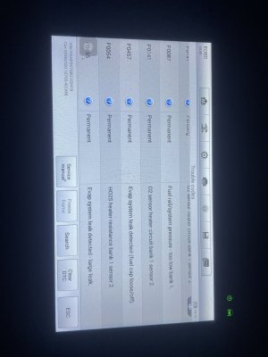

2011 sho will berely accelerate. Ifyou go wot it does not respond has these codes where do i start?

Record, clear, drive, retest. Show the full code (PXXXX). With this little bit, it looks like a fuel issue. Either sensor, lack of fuel or an injector(s) stuck wide open.

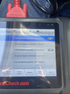

Any chance the o2 would cause this?

Faulty--fuel pressure sensor, pump, leaky line,, Not enough fuel or pressure in the rail
check fuel pressure at the rails and make sure it is within spec.
Same bank for O2 sensor failure.
Usually codes are listed in order of importance so my 1st guess is fuel over O2 but you could be right. Not enough experience with this specific fuel system.

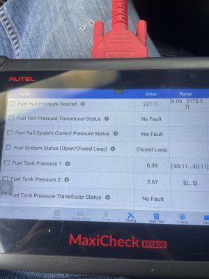

I would Record, clear, drive, retest. Show the full code (PXXXX). The full list and fault code numbers will go far in diag. Generally, once you start looking up codes, they will say ignore X if Y is present. No, I do not think it is an O2. That would normally trip the O2 code maybe a bank lean/rich code, maybe mess with STFT/LTFT. With the first picture showing pressure is low, I would suspect a lack of fuel, a bad sensor, or stuck open injector(s).

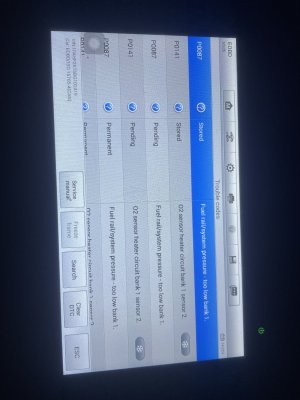

Has these codes

p0087
"When I had my LPFP replaced the dealer test drive resulted in the motor dying and failed restart.... Which was the original problem I had. I also had a communication code when I looked with my tuner before that dealer trip. Anyway, they replaced the fuel control module next... (sorry, don't have the part number handy)... And that resolved the problem for me. Apparently it was the major problem due to sending bad information to the ECU. After that she's been flawless, if not better than new. I believe the units begin to partially fail for some time before enough happens to set a DTC. My service advisor looked it up and said that HPFP failure is pretty uncommon... So the FRP drops because the HPFP can't get the fuel to pump. Hope this helps."

Has these codes
