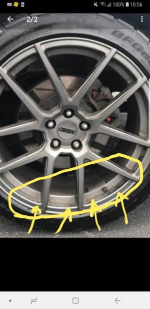

They're nice wheels, yes.
However "always" is a pretty exclusive term.
Judging by your own posted image, I'd hardly agree that they're clean. At least not in the proper sense for most of us OCD types here.C7c94af1f98c747d8f34e8fe03c85936
LOL Like he said!
