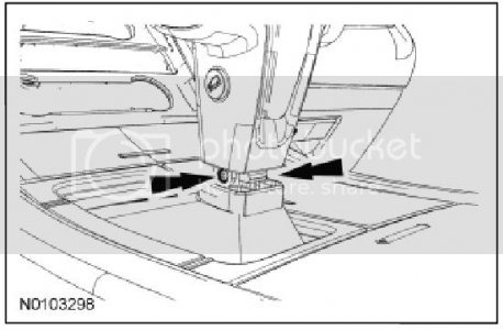

Hey all, haven't been able to find a previous thread and by looking at the car myself didn't see a quick and easy way to get at the shifter/handle. Mine has a bit of a wobble on it and I would like to tighten it back down but don't know how to get at it. Anyone with schematics or knowledge that could help would be greatly appreciated. 2010 model.

I remember posting the few steps from the service manual, but don't recall where. I found the image quite easily. The steps are basically to lower the trim ring (no details how to do that) then access the little screws for the ****.
2011TaurusKnob zpse115e595

When you figure out how to lower the trim ring to access the screws shown - please share your technique. might come in handy some day.

My shifter was loose a while ago and when I had it at the dealer I asked the tech he said you just pry down on the chrome ring and it will pop down. I'd use a plastic putty knife or other trim removal tool.

I had a loose shifter handle and applied used info above. I took two short wide blade regular screw drivers and pryed down on the trim ring from both the driver and passenger side. Then the trim ring pops back up after tightening. Thanks!
