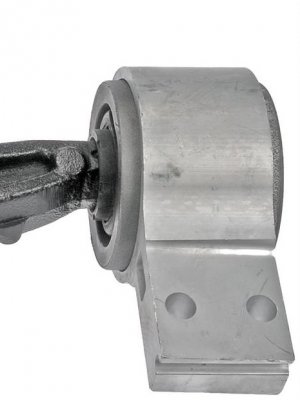

I'm curious what was used for the large bushing that has to fit over the hexagon post of the front LCA then? Your race shop found something "close in all dimensions" for that? LOL
Anything can be made. Duh....pretty much anyone here understands that.

So the only bushing I remember being awkward in shape was this one. What we did was got poly material. Put it on a lathe. Faced it down to length, left a seatface with a slightly larger od. And machined the rest of the od to snug size. Center drilled through it and bored it to a brass insert diameter that was bored .0035 over the fastener diameter. Worked out pretty well. My shop also made me solid round poly bushings for my miata diff carrier years back before my apprenticeship. A year or so after people were making them themselves FM came out with a solid piece they make for sale but its at a steep cost
