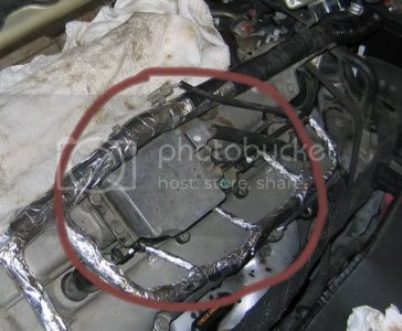

Haha... it's hi-temp aluminum tape. I snapped that shot before the rest of the wiring looms were double wrapped.

thanks pcross 53. that pictures gives me a good idea where to start. i was at autozone and theres 3 parts to the idle speed control, the relay, actuator and motor i didnt know which i needed so i held off. im goign to check the irmc now if the wire is frayed i have no choice but to get a new one? also any one have any info on where i can get a shop manual for the gen 3's?
