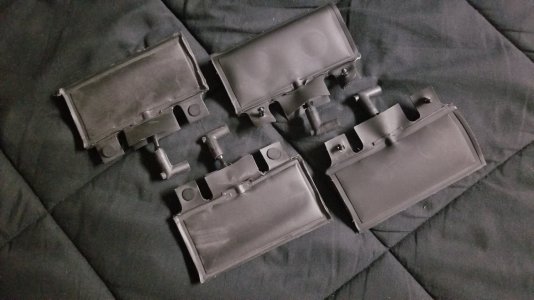

From a cloth late '94 with power everything. Kia ABS recall for scale.

Interesting how yours has plastic pins, as per the book, but mine had metal rivets. Ford...you keep doing you :p
