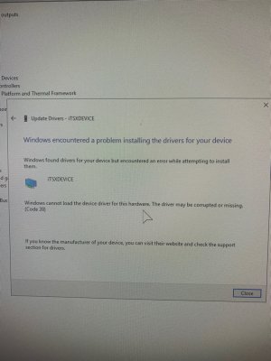

Anyone experience this error? Frustrated I can’t get anything done C80bddcf1b14fe75472844420dda8ddb

I'd try and go to the sct site and download the latest drivers directly from there. Make sure you're on the most updated windows update as well, or you're likely to keep running into errors with driver conflict.

Also try a clean install. So if you have any previous drivers or anything relating to sct, delete it all and reinstall.
That error was immediately after getting all drivers from SCT. That’s what’s weird. I’m not sure if I missed something. I also installed from the sct device updater. When I go to live link and try to establish comm, it force closes out.

That is odd, but it is windows 10. Nothing really surprises me anymore.
My tuner will be here tomorrow, so I'll try and install the drivers and see if I get a similar error.
Is the device connected to the pc? You may want to disconnect it if so and try again. You may also want to try and contact sct support and see if they can help directly.

Of course SCT support is closed for the weekend. I disconnected and installed and installed with it connected.
I’ll uninstall completely and try again. Hopefully it’s not a faulty tuner

Okay. When you download livelink, just make sure device isn’t connected to the computer. I uninstalled, unplugged tuner, reinstalled livelink. From there I did the “open” then “configuration” put in the .cf4. Hit the “comm” button. At the next screen, plug in device, wait for the “main menu” screen to pop up the hit “check communication” button.
Worked perfectly from there.
