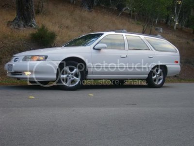

wire brush on the end of a craftsman 18 volt drill. You guys are scaring me. This car also needs paint due to hail damage. I am seriously wondering if I should just drop the subframe in the car pictured below

Shit, I hate to canabalize ti but the more I look at it the more my white one looks to be in better shape. If course, swapping everything over is not going to be a cakewalk either.

It's a bummer, I don't know wether to continue or cut my losses and do an engine swap w/another car - example, I found a Sable wagon, 93 3.8 w/blown head gasket, perfect body, no dents, scratches, or rust - $350. I am hesitant to do a swap w/my 95 - it runs too well to chop up.
I am really wavering here, as I am not wanting a SHO just to get me around, I want a nice car that will only be summer driven - that's why I am hesitant to pump $'s into this one. On the other hand, I am not sure electrically what needs to be done for a swap - Like what exactly I would have to grab from the dash besides the computer and it's main wiring harness. Here's what I'm dealing with:

I had a body guy come out and look at the car - he says it is solid and worth fixing. No holes in it that we can see so I am sticking with this wagon. I had found a nice sable w/a perfect body but it was biege - who wants a biege SHO? I could do the flip and swap into my white one but 1. white one runs perfect, 2 I would have to swap everything and I would want the black interior so it would be a shitload of work. I even thought of putting the 95 slo drivetrain in the sable and putting the SHO wagon's d/train in my white one but that would be more work then what those hobbits had to do in the lord of the rings movies.

That white wagon looks great by the way.
