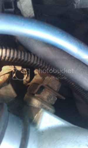

Nah, I'll stick with the 195. About the firewall ground strap that zak mentioned... Where does that mount to the engine? The firewall side is secure, but the other end is just dangling, not connected to anything. A pic would be great if anyone has one. Thanks guys!
7,521
That strap connects to the intake manifold on the engine - the top of the rr intake support bracket is the factory location. if that ground strap is bad/missing, the temp gauge readings can vary all over the place, and in some cases the engine won't even start because of the missing ground.

Thanks. Got that hooked up and did a seafoam treatment in the gas tank and the intake and between all of the above it doesn't stumble anymore when I start it up. Not sure about the temp yet. Haven't really driven it much except to blow the crap out from cleaning the intake. I'll let you know if that problem is all taken care of now. Thanks again guys!
