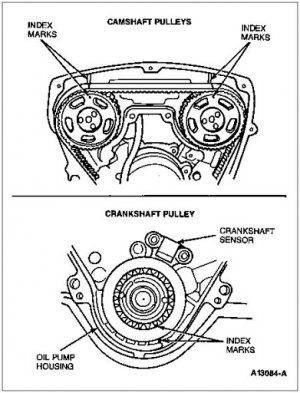

Even with the timing belt off you will still be ok as long as you line everything back up before you install the timing belt. These cars are very easy to work on!
Each cam sprocket has a dot on it that lines up with a mark on the rear timing cover. Likewise, the crank sprocket has a dot on it that lines up with a mark on the oil pump. With these three marks lined up you are good to go.
If the belt is still on the car then you can verify the timing marks on every 2nd rotation of the crankshaft. The cam sprockets and crank sprocket will line up every 2nd rotation.
