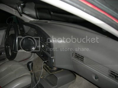

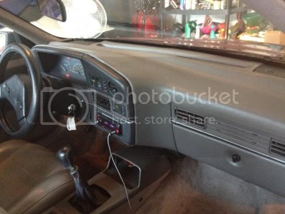

Here's mine. Ignore the loose bezel trim and in the 2nd photo (taken just now), I'm going to have to re-glue some areas and hold them down with a C-clamp. You may have to trim/dremel around certain areas and be sure it seats correctly. I'm sure I could have Gorilla glued it vs. use clear silicone like they say, but I wanted the ability to pull it back up and re-seat it in the event that it started doing what it is now. I used some NOS Ford Dark Titanium interior paint that I got a hold of. Had I put a 2nd coat on the dash cover, it would have matched perfectly. I also did my sunroof shade (scraped off the cloth and just painted the plastic). Since I did 2 coats of paint for that, it came out to match the lower dash exactly. I don't think I have enough to recoat the dash cover though.
DSCN1283"]DSCN1283[/URL]
Today
Get attachmentaspx zpsc2605e66
