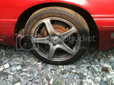

My '90 is a track car. It has a Gen III front subframe, Koni shock inserts and Eibach springs. It's got our Original Subframe Bushings and Original Subframe Connectors. It also has 13" Cobra brakes and Performance Friction T1S Racing Pads with our Original Custom Stainless Steel Brake Lines. I have 17" wheels (cheap chinese crap, but it does the job) and Kumho Victor Racers. The engine is a built 3.2L with ported heads and Stage I cams. I am using one of our Killer Clutches and one of our built transmission with a Quaiffe differential.
IMG 0510
IMG 0509
I just came back from Virginia International Raceway and couldn't be more impressed with the car. I ran 5 sessions and had an absolute blast. The car is an animal on this track. The track is great because it really caters to the FWD platform. All the corners apex very late. The first session was pretty comical as I was lost most of the way around. But after a few sessions, it was full on. I was going 120mph into turn 1, and braking at the 300' marker. The next straight starts with esses and ends with esses. This was my favorite part of the track. I was going into turn 6 at about 60mph and foot on the floor, then shifting into 4th before the bridge. I'd ease up to set up the up-hill esses and pour the power on. I was topping the hill at 110mph. Oak Tree has a big freakin' stop sign and you've just got to wait for it. But the back straight is llooooonnnnnngggg...and up hill. I was going into turn 14a at 125mph.
The point is that the suspension was only lacking in one area. I still need to get our Original Aluminum Rear Control. At the top of the up-hill esses, I could really feel the back of the car and if felt top heavy. The car felt like it was rolling over on a high center. It was very predictable, but I would like it to be more stable.
So even after 5 sessions in the heat, the tires still look new. I'm not even rolling the tires over to the edge of the tread. Guess I get to push a little harder.
I also need to install our custom oil cooler system. On a 96 degree day, the temp gauge was running on the N. Our oil cooler system will help keep the temps low and makes sure the engine lasts a long time.
What a great track. I'll be going back for the Labor Day Weekend to take on the PCA.
