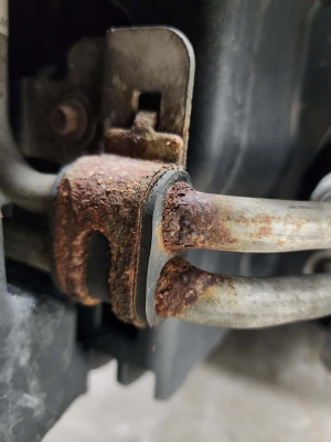

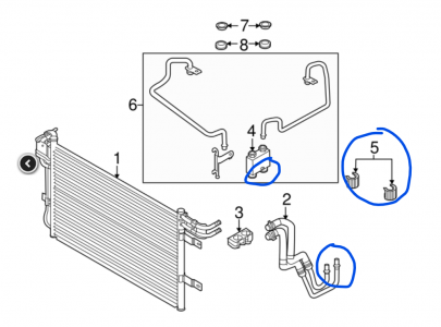

The transmission line going to the radiator started leaking, line rusted under the bracket
1715711911730

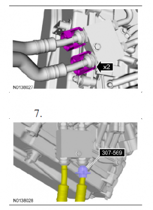

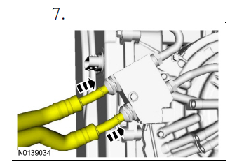

looking at the parts diagram, it shows two clips that secure the lines to the by-pass valve
1715712050798
1715712234445
My SHO doesn't have these. Has anyone replaced this line or removed the tranny that can provide any guidance?

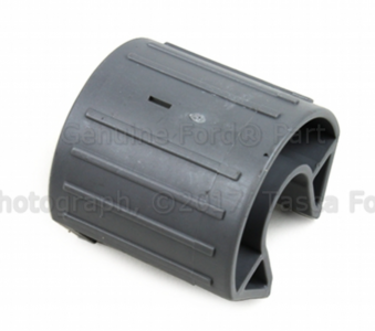

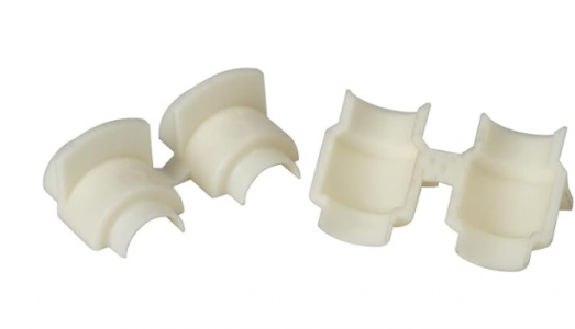

Is it a matter of inserting the special tool and then pulling the lines?
Do I need to buy 2 of these and do them at the same time or can I just buy one? The ones you shared don't ship to Canada and Amazon.ca wants almost $70 for 2. Found a local website that sells them separately.

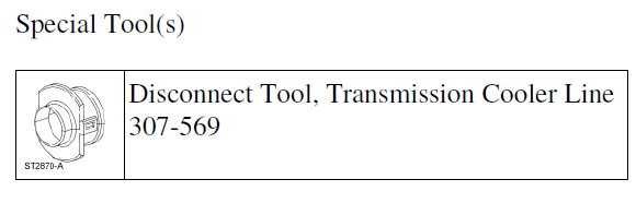

I read the workshop manual but it doesn't provide any details on how to use the tool similar to the one you shared.

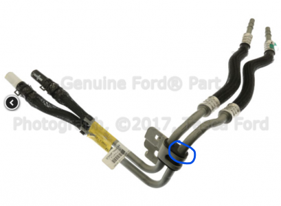

To install the new ones, is it just a matter of pushing them in?
1715779233272

Reviving this thread as i just found my trans lines are also rusted thru. Did you ever figure out which tool works the best? Also is the part number #
DA5Z-7R081-A​
