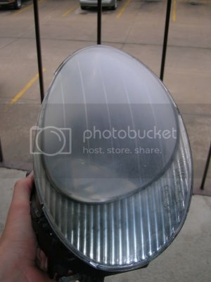

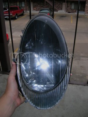

So sometime in my car's life it was hit on the drivers side. Anyways that headlight has always been much clearer as it was a new Ford replacement.
Picked up another headlight off of eBay from a 99 so I'll take some before and after shots of the entire front and of the passenger side of the car. I can't wait! I just hope it is as clear as it looked in the ad :p
Good side:
DSCN0704 1
Bad side:
Badheadlight

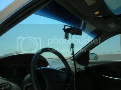

send along a pic of your front tint strip

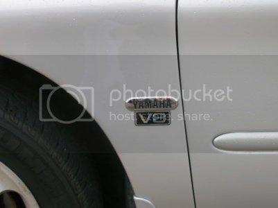

are you saying you need a front grille piece? I have one but w/o the emblem holder. sometime in its life screwing around with the Yamaha one I broke the mounting hardware, as far as I remember , but I bet you could swap yours in no sweat. PM me if you want it and you can just pay shipping?

Yeah I'll take a pic of the front window strip. Naturally, I did it, as I've done all the tint on the car since I bought it, and it looks good. I could have maybe pulled the passenger side down a little more, but it is only off from the drivers side by maybe 1/4". So it is unnoticeable.
I just wanted to make that strip wider as my car has the legal tint on the front windows. Plus I had the stuff left over so why not :)

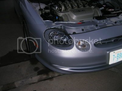

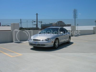

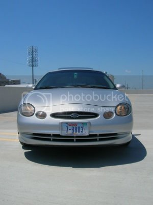

Chris, here are some of the photos of the windshield strip, and of my ugly headlight. You can see Memorial Stadium in the background. GO BIG RED!
ScannedPhotos007
ScannedPhotos009 1
Ewwww
ScannedPhotos008 1
ScannedPhotos005
1024fronttint
You can't really tell there is a strip there unless you notice that it is not a gradual fade from the factory tint, and it's all black. Most noticeable inside the car.

Looking good so far. Mine has a clouded up headlight like that too. No amount of polishing seems to get it cleared up either. So that's on my list along with repaint of front bumper and hood.
I finally laid into my very scratched and dulled over lense covers a couple of months ago with one of those 3 stage scratch removers. Got them almost back to as new clear everywhere except right at the edges, where I could not get in as much pressure without removing the lenses, and I was too lazy for that. :cool: I think it was a 3M one, and it was not all that expensive. Maybe $15 for the small bottle set or so.

Stephen what did you use again to polish the lights? A store bought product I assume?
stephen newberg
Jan 15, 2001
3,370
398
Ladysmith, BC, Canada
Yes. Well, a specialty plastics store. Specifically it is:
Novus Plastics Scratch Remover, #3 and #2. 3 is for the heavy scratch removal, and 2 is for the ligher scratch removal. There is also a #1 that is a pure polisher for very light scratches, but I did not feel after doing 3 & 2 that it was needed. I was pretty impressed by how well it worked.

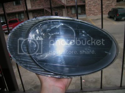

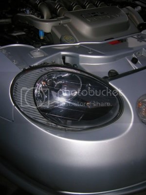

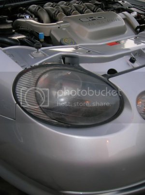

I can't believe how perfect my headlight now is. Makes my clear driver side one look like poo. Time to go buy some polish, or buy another one from eBay.
Before
ScannedPhotos013
And five minutes later
ScannedPhotos016
ScannedPhotos017
Completely Satisfied as this headlight was only $36 shipped

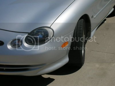

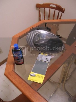

Before and after, this is on the old headlight
DSCN0876
DSCN0877
DSCN0878
DSCN0881
DSCN0892
Headlight refinishing paste, 2000 grit sand paper, and a towel. Seemed to work pretty good, but it's not as clear as the replacement headlight was.

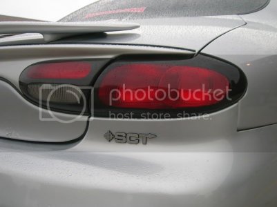

A sneak peak of other additions...
DSCN0889
DSCN0886
DSCN0885
