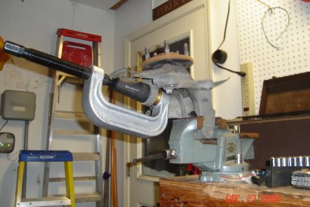

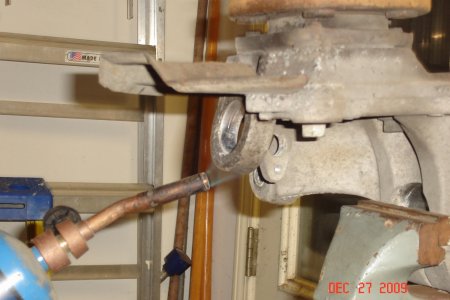

Unfortunately, the LCA isn't the hard part. You have yet to deal with the rest of the crap in there, such as the hub and actually getting the ball joint out of that.
