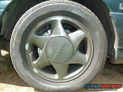

go with gunmetal, it's real easy to do with duplicolor wheel paint and the clear that goes with it.
Getfilephpid119460togglefullsizefDSCF0051
Word of advice, unless you're getting new tires, mask them off pretty good, mine look kinda wierd. Just spray 3 coats of paint and 2 coats of clear. Paint comes in a couple other colors too. Scuff them up real good, clean with tack cloth, and spray. Let the paint dry for 5-10 mins between each coat and preferably, let them cure for at least 24 hours before reinstalling. Good luck,

But you've got to admit, your gunmetal looks very different from mine. That's the beauty of powdercoating. Mine look nice for about $15 bucks in materials, but yours are a work of art for a bit more money. To each his own I guess.

Yeah, I heard that somewhere on these boards too, but I couldn't tell you. All I know is that the paint stuck pretty good when I sprayed mine. My only complaints about using paint is (and I don't know if this is an issue with powdercoating or not) that removing the center caps with a flat-head screwdriver can dig into the paint if you're not careful. I should have had my wheels balanced before painting since the guy at Bridgestone/Firestone obviously didn't care that I painted them. He even DROPPED one of the center caps when removing it, while I was watching too. I was kinda ******.
Anyways, either way you do it, I'm sure you'll be happy with gunmetal.
