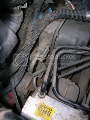

First, remove your air box and the 2 10mm bolts holding the ABS computer up.. this will allow easy access to the two fittings. the pic shows the two fittings the square metal cover things on the line pull off, then press the sides of the plastic clips and pull the lines out..... (tranny fluid will leak out)

Second use a 7/8 wrench on the head of the fittings still in the tranny and remove them (tight area but they will come right out)... now put thread sealant on the fitting you should have already bought.. see pic
