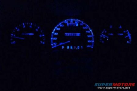

I was wondering that myslef rofl Looks good though, too bad its not for real (must be camera flash or something)

Looks sweet! And I dont think the blue lights are fake, I'm assuming he replaced the dash lights with blue ones.. Looks sweet man! :thumbs_u:
lol :)
Your's might be a shady camera, but it is doable.
