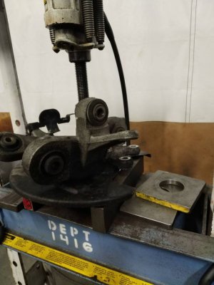

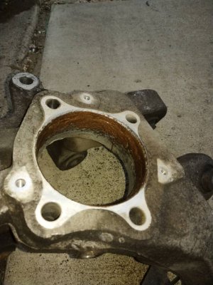

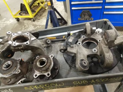

I replaced them on my friends 2010. Pain in the ass. I've replace lots of glued and siezed Ford wheel hub bearings and these were the only ones that wouldn't budge from my 5lb sledge. Even with the entire knuckle removed and beating the backside of the bearing, soaked with kroil. Bother rears were like this. I took them to work to the 20ton press. It took a scary amount of pressure before they broke free. I thought the knuckle broke.
144k miles. Michigan car. Salt City.
