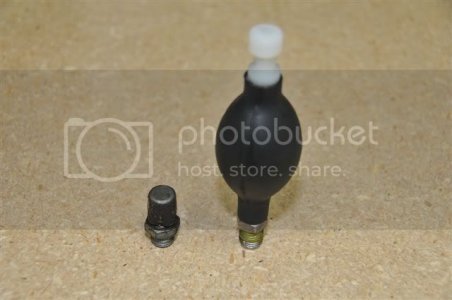

Maybe the fluid was overfilled in the RDU? May need to replace the vent or reseal the vent threads with PTFE tape. On the Mustangs, they actually replaced the vent with a bulb-type design:
AxleVent023
BTW, you have not had your PTU or RDU submerged? If you have, then a fluid exchange and/or unit replacement is recommended.
