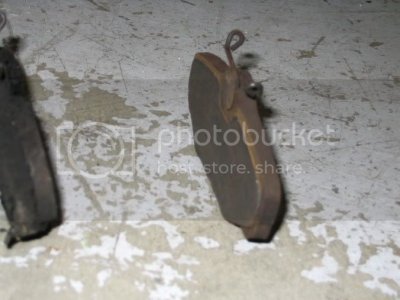

Ok, I redid my rear brakes 15k ago and now they need attention again. 15k ago I put in rebuilt calipers, new brackets (new slider pins), new rear hoses, and bleed out the entire system for the first time in its life (it was at 155k). So, now I take it all apart and on my passenger side brake pads have worn significantly unevenly. Here are some pics - what would cause the wear like this to happen? The pictures show the outer pad having barely any material left on it and the inner pad having about half.....

Upon inspection one of the boots for one of the slider pins had come off - so the seal wasn't perfect - but the pin still moves freely. That is the only evidence I could find that was problematic...would that cause this? I don't want to replace the pads and have this happen again...so what action do I need to take here?
